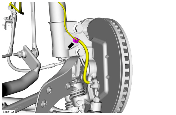

    Unclip and position aside the wheel speed sensor harness.

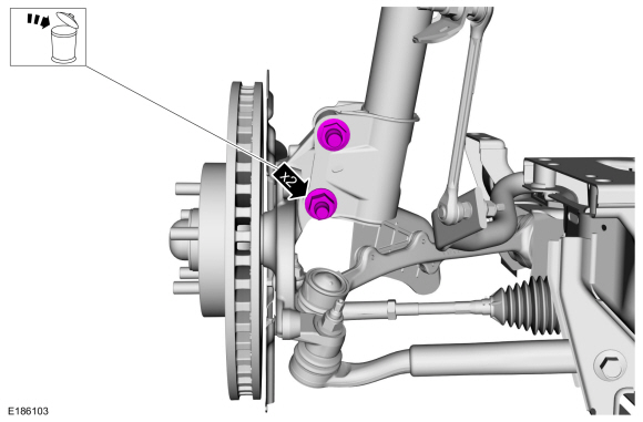

    Remove and discard the strut-to-spindle bolts and nuts.
imagen2.dll?id=E186103_EUR&w=580&t=JPG
  1. NOTE: Support the wheel spindle using mechanic's wire.
    Note the orientation of the strut-to-spindle bolts and flag nuts, then remove and discard the bolts and flag nuts.

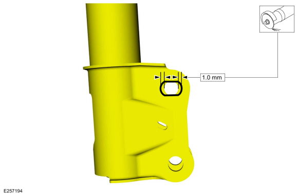

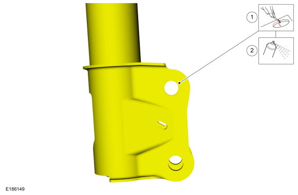

  1. Using a suitable grinding tool, enlarge the strut-to-wheel spindle upper mounting hole as indicated.
imagen2.dll?id=E257194_EUR&w=580&t=JPG
    1. Remove any burrs.
    1. Clean and paint any exposed metal.

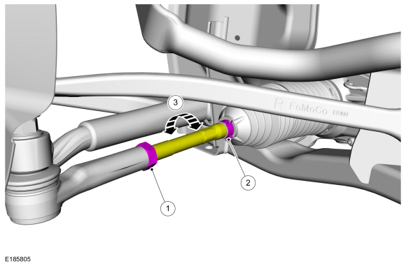

      Loosen the outer tie rod end jamb nut.
      Torque: 76 lb.ft (103 Nm)
    1. On both sides.
      Position aside the steering gear boot clamp.
    1. NOTE: Do not allow the steering gear bellows to twist when the inner tie rod is rotated.
      On both sides.
      Rotate the inner tie rods until the toe reading is within specifications.
imagen2.dll?id=E185805_EUR&w=580&t=JPG

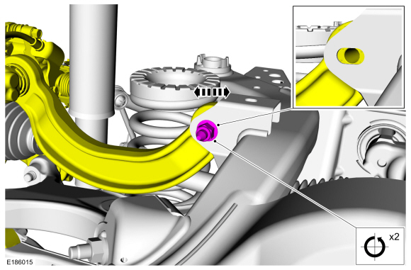

  1. Using alignment equipment and the manufacturer's instructions, measure the rear camber.
    Use the General Equipment: Wheel Alignment System
  1. Loosen the upper control arm inboard nut approximately 2 turns, and slide the upper control arm inboard or outboard to adjust the rear camber.
    Torque: 85 lb.ft (115 Nm)
imagen2.dll?id=E186015_EUR&w=580&t=JPG
  1. Recheck alignment to verify camber change and adjust rear toe if necessary.

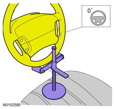

  1. Using a holding device, hold the steering wheel in the straight-ahead position.

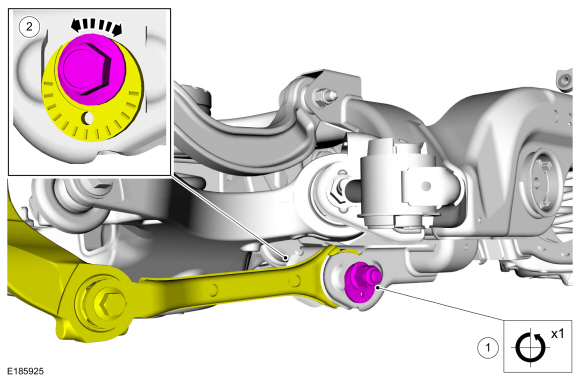

    1. NOTE: Make sure that the toe settings are not disturbed while tightening the nuts.
      Loosen the toe link nut approximately one full turn.
      Torque: 129 lb.ft (175 Nm)
    1. Rotate the toe link bolt to achieve the specified toe setting.
imagen2.dll?id=E185925_EUR&w=580&t=JPG
  1. Recheck the rear toe settings and adjust as necessary.

Helt bisarrt att man skall behöva slipa upp hålen där fram för att justera camber.
Är nöjd med den främre inställningen dock... Är ju dessutom brutala toleranser dom har. 1.71 grader +/- 0.75? En sovjetisk traktor är ju mer finstämd än så.
Där bak är det som jag påpekade till mekanikern ett ovalt hål i fästet för kontrollarmen, gäller bara att justera på rätt sätt - kräver väl att man lyfter bilen, justerar ut max, ställer ner bilen och släpper in den till den hamnar rätt om jag förstått det rätt?

Att justera in cambern bak med originalbultar är ju enklare än ut då bilen kan stå på hjulen (så länge dom inte släpper in den för mycket.) Behöver även mer toe in fram känner jag för den är ganska flytande på vägen som det är nu mot tidigare. 0.02 / sida är för lite, släpper jag ratten med lite vänsterutslag spårar den inte in sig riktigt. Visst är vägarna varierande men efter empirisk forskning under gårdagen på alla möjliga kul vägar så känns den för svampig i styrningen runt 0-läget.

  1. Using alignment equipment and the manufacturer's instructions, check the front toe setting on both sides.
    1. On both sides.
    1. On both sides.
      On both sides.
  1. Recheck the toe settings and adjust as necessary.
imagen2.dll?id=N0152580_EUR&w=400&t=JPG
  1. Using alignment equipment and the manufacturer's instructions, check the rear toe setting on both sides.
Oavsett fick Hedin Fordcenter kolla på siffrorna idag för en second opinion och dom tyckte värdena såg bra ut och sa att man väl kanske inte brukar justera cambern där bak normalt sett. Dom tyckte det var bättre o köra ett år och sen ta en ny justering i så fall, det som stör mig är ju dock att den ena föll från 2-1,5 när toe justerades... Får väl kanske acceptera att det är ok även om siffrorna stör mig 🙂
